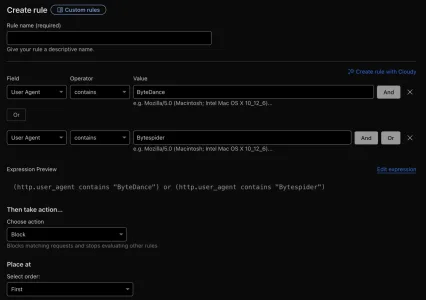

There is no "contains" operator for user agent rules. If you want to use "contains" for user agents, you can use a firewall rule (more flexible, but also more complicated):
The rule someone posted above is mostly right... general idea anyway (except ByteDanceSpider isn't a user agent that would match).
Again... not a specific user agent rule, but it also doesn't need to match exactly.

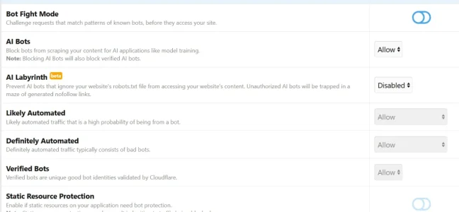

Thanks. Just checking I've been looking in the right place in the app. I was under Firewall - User agent - to set up a rule.
In settings there is a Bots section - should I be using that instead? Although don't want to block all bots obviously.

User agent rules are exact match. The issue is you don't have access to your web server logs, so you don't actually know what the user agent is (exactly anyway). The link I gave you above will allow you to do user agent blocking with a contains operator.

How about the AI Labyrinth option in the addon?
I've sent a request to the server to block ByteDance and Bytespider at server level, which I believe some servers do. But they will probably ignore me 😂
Well if they are hitting the server direct, none of the Cloudflare settings will do anything because the traffic isn’t passing through Cloudflare.
