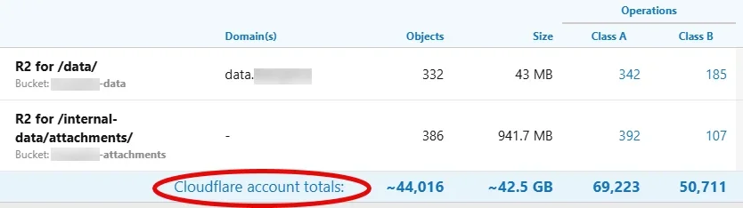

Suggestion: instead of (or in addition to) showing "Cloudflare account totals" in the R2 admin ui - is it possible to just show totals for the zone? Or more specifically totals for the buckets we have setup for this site.
Obviously if you're just pulling that total from some API data rather than calculating it yourself, it may not be worth the effort - but if you're calculating it yourself, it might be more useful to show the total usage for just this site rather than for all zones across the account?
It's technically possible with just a template modification... the data is already in there (you just would be adding the two numbers together from the bucket lines). However, I'm not sure if that would actually be better... the account totals are there to give someone an estimate on where they are at for billing purposes (R2 is billed at the Cloudflare account level, not at the individual bucket level). So you would be replacing something that serves a purpose (billing estimates) with something that is just 2 numbers you can see that are simply added together, but don't serve any useful purpose.
