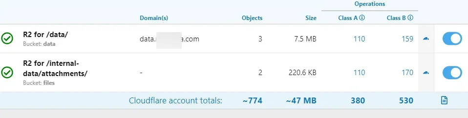

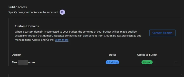

You mean I shouldn't connect this bucket (for internal_data/attachments) to a domain like this?
The thumbnails show up after I connect it to the subdomain!
Correct. See previous post.
OK, just remove the file.mysite.com connection. The corresponding DNS entry for this bucket is also automatically deleted.
I suppose the following is correct? data goes with domain connection while internal_data doesn't have one.
And the thumbnail still works. I'll check again tomorrow. Too late for my time now. Thank you for your kind help.
Ya, that’s one way to do it. You could also just ignore it since it’s really only an issue if you use the token auth option (normally XenForo can handle setting the content-type header).
