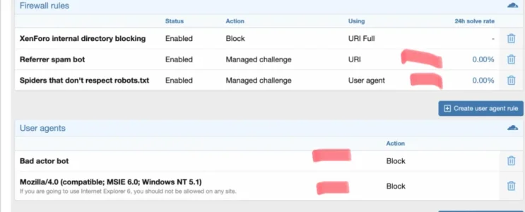

Hey there I’m trying to set this up in my cloudflare but Im a bit confused with these in red. I create a rule and enter example referrer spam bot but i don’t see a managed challenged in my action drop down menu. As for the user agents i manually enter mozilla the way you have it? Thanks!
Those aren't valid rules. I mean I guess you can if you know what you are doing... that will block Internet Explorer 6 just because it's IE6.
As far as no drop-down box, can you post a screenshot of where you are looking that doesn't have the drop-down box? It's there when I try it.

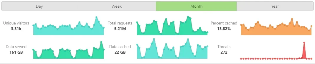

I wanted to take a moment to express my gratitude for the [DigitalPoint] App for Cloudflare® 1.8.6. I've been using this addon with XenForo 2.3.2, and it has truly been a game-changer for my setup.
After configuring my server to only accept connections to ports 80 and 443 from Cloudflare's IP list, I have noticed a significant improvement in both security and performance. The integration has been seamless, and the metrics I've been monitoring show that everything is running smoothly.
The visual insights provided by the addon, particularly the detailed analytics and caching information, have made it much easier to keep an eye on the health and performance of my site. I'm particularly impressed with how well the caching and threat management features are working—my server's workload has decreased, and the site feels faster and more secure.
So, a big thank you to the team behind this addon! Your hard work is truly appreciated, and I highly recommend this addon to anyone using Cloudflare with XenForo. Keep up the great work!

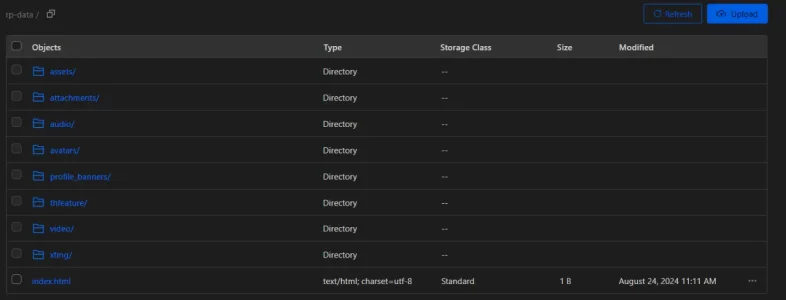

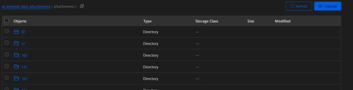

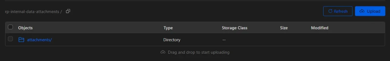

I just moved data and internal_data to R2 buckets as described but actually I have a strange issue with XFMG (quite sure it´s not that strange when someone knows more than me ;D) - maybe you (I know you´re not using XFMG) or someone else can point me in the right direction.
First link is an image that has been uploaded after migrating to R2 - https://rollerplausch.com/media/testplausch_1000x130-png.21125/
Second link is an image that has been migrated to R2 - https://rollerplausch.com/media/hall-sensoren-jpg.21118/
If you right click on the first image and select "Open picture in new tab" it will be served from bucket, while the second will ask me to download .data file?
I have also attached pictures from the buckets. Edit: Buckets have been configured via Addon ofc.
Any help/hint would be highly appreciated.

The first one doesn't exist, the second one looks like the object in R2 has the wrong content type, so the browser just downloads it. Disable token auth under R2 settings, then it will use the content type that XenForo thinks it is. Using token auth makes it so you are relying on the content type as set in the R2 bucket.
As for why the content type is wrong in R2, I'm not sure... how did you move the existing data (most likely it was that process that explicitly set the content type to something incorrect when it was uploaded).
Thanks for your reply. First one should be available now too (deleted wrong image). Indeed disabling token auth makes it work.
I used rclone to transfer the folders:
rclone sync internal_data/attachments rpdata:rp-internal-data-attachments/attachments --verbose --transfers 10
rclone sync data rpdata:rp-data/ -vv --transfers 10
We are talking about the internal_data bucket am I right? Having a quick look type is set to "application/octet-stream". If you could give me a short heads up how to find the correct hash for the images from the links posted I can provide the detailed infos on the bucket items if needed.
Should I recreate the buckets and use your migration tool or did I miss something with rclone or...?
Cheers,
Chris
Rclone explicitly sets the content-type to whatever it thinks it should be based on the file extension. Not sure if there’s a way to tell rclone to not do that or not. If you use my migration tool, it doesn’t do that.
Ok got it, so rclone is the culprit more or less (or I´m too dumb to use it).
I´m running on buckets since yesterday and there have already been uploaded some attachments, images, etc to them. Could you think about an "easy" way to fix that? Would be migrating from R2 back to local file system with your tool (if possible) and then again migrating from local file system to R2 a viable path?
Or can I just rerun the migration from local file system to R2 again but this time with your tool and it will sync/overwrite the data with correct content-type?
Ya, that’s one way to do it. You could also just ignore it since it’s really only an issue if you use the token auth option (normally XenForo can handle setting the content-type header).

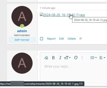

XF2.3 with R2 enabled.
I tried to add an image. Insert thumbnail results in the following broken image (click on it get the full image without problem though). Insert full image can include picture.
What could be the problem?
And I set data.mysite.com and files.mysite.com for data and attachment buckets. But why isn't the URL for internal_data/attachment files.mysite.com but mysite.com/attachments as the following? I can confirm the files are uploaded to R2. Files in data as displayed as data.mysite.com though.
No problem with R2 disabled.
Internal data is exactly that… internal data. It’s not supposed to have a public domain assigned to it. Whatever you did outside of the addon config UI for R2 is either wrong or you have a very specific non-standard use case that only you know.
Unless you have a reason unique to your setup to do it, I’d undo whatever you did manually (like add files.mysite.com as a public domain).
TL;DR: if the addon doesn’t offer to set something up for you automatically, it’s not because I couldn’t figure out how to do it, it’s because you shouldn’t do it (again, maybe you have a unique use case, but if you do, only you know why).

I inserted an image in a message and it shows a full image but when I "insert thumbnail" it shows an empty space in the editor. After I posted the message, Full image is there and the supposed to be thumbnail becomes a broken image with a link. Clicking the link will show an image.
So what makes the thumbnail not appearing? It's just a jpg. It's a fresh server.
