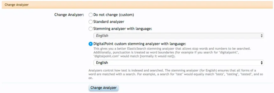

  • New analyzer option: Custom stemming analyzer with language (indexes numbers, treats punctuation as stop...
One thing in the new version is it makes it really easy to apply a better analyzer rather than mucking with your server-side files.
It's the stemming analyzer we have used on Digital Point for a long time and honestly I'm not sure what I would do if I wasn't using it. lol
Allows you to search the following:
  • Numbers
  • Normally ignored stop words
  • Punctuation within a word is treated as a word break
An example of the last part is if you search "digitalpoint" on xenforo.com, "digitalpoint.com" doesn't match because the period is considered part of the word. Using this stemming analyzer, it would match. Same if you were searching for a XenForo class name in a post. A search for "elasticsearch" would yield a post with "DigitalPointSearch_Model_Elasticsearch" in it, while it would not with the default stemmers.
