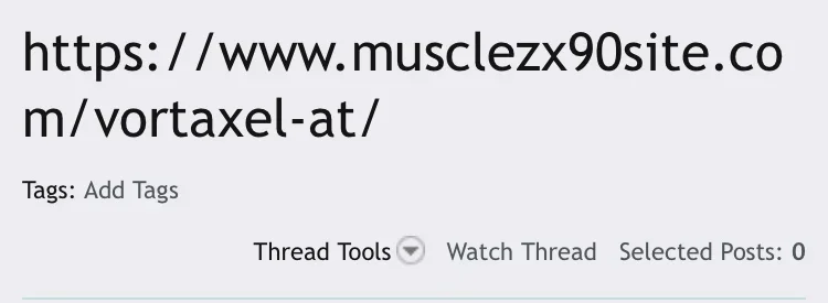

The only spam that gets through all the spam block thingy's I use are those that use a URL as the thread title

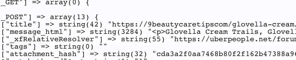

I get up to a dozen posts a day pretty similar to the the screen shot attached. There is no link in the actual post body
I don't want to send all new posts to moderation
Any tips on a way to automatically block URL's as the thread title?

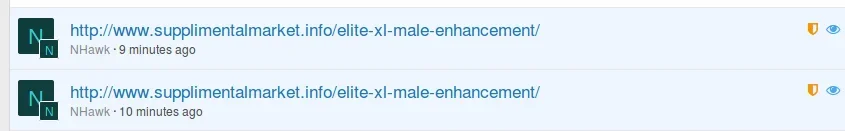

The begging of the string is not always how these spammers post "links" in the title from what I've seen, and they certainly don't always start with http or even www

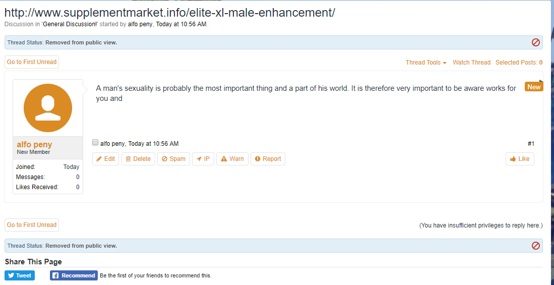

For example

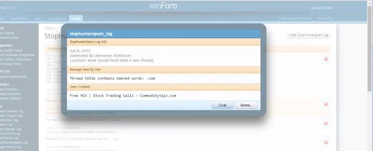

@Mike, we are using this phrase and it's catching some but not all? First attachment shows trigger log catching one and in moderation, second attachment shows post going through? Most are going through. Any ideas?

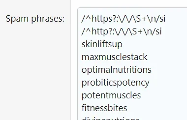

I have both /^https?:\/\/\S+\n/si and /^http?:\/\/\S+\n/si as part of my spam phrases yet messages with URLs as topic are still getting through:
What am I doing wrong?
I know this thread is for Xenforo 1.5 and I am using version 2, but I'm assuming this should still apply to version 2?

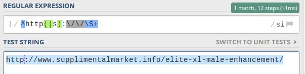

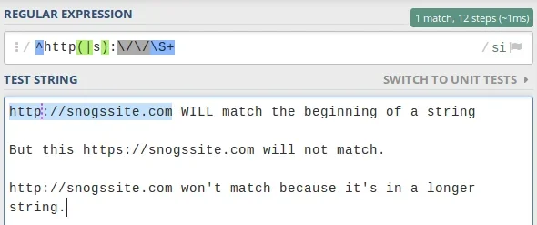

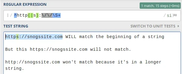

I've tried /^http(|s):\/\/\S+\n/si and /^http?:\/\/\S+\n/si and I am still getting spam where the title of the post begins with http. Is /^http(|s):\/\/\S+\n/si working for anyone else?
I've got these two.
/^http(|s):\/\/\S+/si

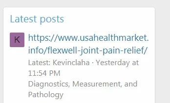

threads with urls are still getting into my website :(
It shouldn't be getting through, especially in the title.
Automatically moderated with that regular expression...
Double check that you don't have registered users able to bypass the spam check..
