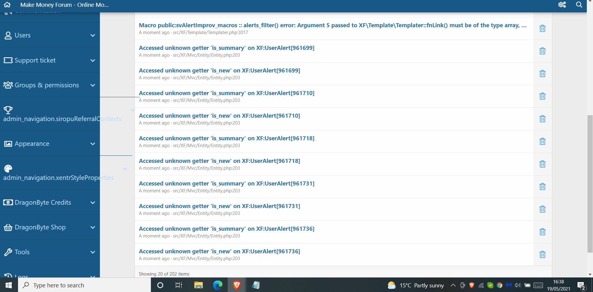

Interestingly, there are other signs of strange things going on.
Is this anything to do with the merging of one site into another? I notice one of your sites is closed with a message to that effect.
I think you need to slowly analyse what changes you have made to either/both sites and attempt to backtrack to see what has gone wrong somewhere.
According to our records, the other site now has a board URL of bizdustry.com. Is that expected?
As for the nav bar and add-on names not displaying correctly, this implies that the data for these is no longer present. The phrases for the nav bar would come from a special phrase cache that is written out to the file system under internal_data/code_cache/phrase_groups/l<language_id>/nav.php. Is it possible this file has been somehow overwritten?
The add-on names issue is essentially the same thing but in a file called admin_navigation.php.
You can attempt to rebuild the phrases by rebuilding the master data by going to https://bizdustry.com/install.

Running the install worked and it reset the Nav Bar problem.
I tried to merge the databases so something went wrong there.
Now, it's pulling up an error here: https://prnt.sc/134osxb with the board URL configuration.
The URL's are different and correct. https://prnt.sc/134oubt
