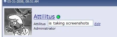

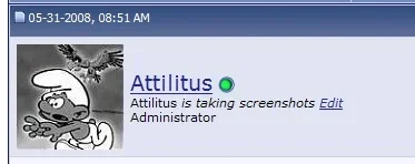

On another note- do you do custom work, I am really looking for a status update like this- it's totally separate from xenforo status, it's done inline in the post bit.
Allows your users to update their status to tell other members what they are doing/thinking at any given time. A user's status is displayed under their names in their postbit, in their User Profile, and anywhere else you choose!
User's can edit their status quickly and easily via AJAX.
Features and Configuration options include:
  • Admin Option: Turn modification on/off
  • Admin Option: Ban usergroups from updating their status.
  • Admin Option: Set a max character count for status messages.
  • Admin Option: Set the number of characters of a status message displayed per line. (Word wrapping will occur for status messages longer than this defined value.)
  • Admin Option: Define a standard status prefix to be appended to the start of all status messages after the username. (i.e. Attilitus is doing something.)
  • Admin Option: Define a default status for users with a blank status.
  • Admin Option: Define the character set used for encoding status messages. (The default value of this option should work for most character sets.)
  • Feature: Status messages may be updated in-line.
  • Feature: All languages and character sets are supported. (Most, if not all, should work with the default encoding option. Others may require some configuration in the admin options.)
  • Feature: Users may press the Enter key to confirm their status update.
Can honestly say its unlikely I will be able to find the time to commit to something like that at the moment due to other things Im doing. Out of curiosity however, why would you use a separate system rather than extending the current one? I know the modification you are looking at and the biggest change to me is the inline updating of the statuses.

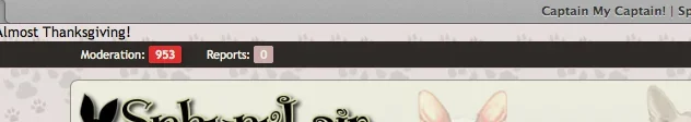

I have the same problem with the default style, I'm afraid - the status shows, but not the word "Status".
Also in common wth an earlier post, it displays at the very top of the screen also. :(
