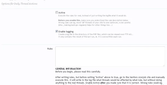

@Mouth
See attached image. (It's not very exiting.)
The rest, below the displayed part, is just explaining text.
