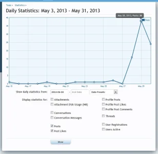

Now I am not sure if this is by design, but I wanted to point this out.
Looking at the stats chart, when I hover over a bubble, the label's date doesn't match the x-axis date.
So if I hover over May 29, 2013, the label will read May 28, 2013.
Is this the correct functionality?

I am a new licensed user and looked up this issue on my site and I seem to have the same issue. I had changed my board from vb (not sure if this matters), but did not notice this til now. Board was down for a few days, so my stats are a little off. I have attached a screenshot.
This is fixed for the next 1.2 update. The higher dates are the correct one as the stats are collected daily based on UTC. Your timezone settings pushed the date formatting back to the earlier date.
