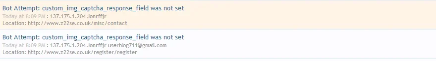

This is interesting (IMO). I never saw this with just FBHP installed, but you can see a pattern with the bots when they try to register.
They first try to register, fail, and they go to the contact page
Yes, some bots do not fill non-default fields
It's easier to set up automation to target the XenForo form with no customisation (but quite a few use the form field index number, and run through the entire form)
For those that just target XF, you will see them not even attempt the CAPTCHA. Other bots try to fill it with QA answers, but have no idea what the question is (they can not read the image, and even if this CAPTCHA was targeted, there are several thousand versions of each of your images, so a binary comparison is quite hard)
I've worked in automation for a while, I know the pitfalls the bots are going to face (especially XRumer, which is the dominant bot)
Some people don't realise, it is easy to stop bots... 100% without even touching an API (But, its not something that can really be done with the core, since then the mechanism will be targeted). FBHP does stop 100%(more than once), customImgCapthca also stops 100% (but some bot users come back an re-attempt, messing a little with the results).
My money is on FoolBotHoneyPot for the mechanism that will last the longest
By the way, you kind of did see it.
Look for logs that don't complete the entire form (I think that's 24 honey pots... I can't rememberer off hand). For those bots that do not complete every field (including the honeypots), they wont ever reach the CAPTCHA... so, they populate the 1st 12-14 feilds then don't bother with the rest

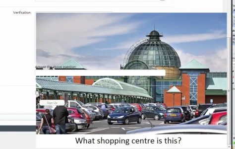

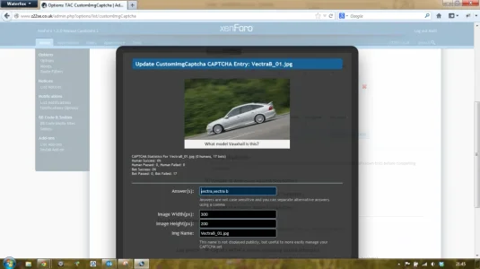

It's VERY impressive! Just trying to build up my collection of images.
Although, have come across a little issue on my laptop at home. I've a resolution of 1336x768 (HP Ultrabook). Both Chrome and Waterfox.
The popup to edit the images drop below the bottom of my screen (even with the task bar minimised).
I can only get to the bottom if I F11 and set the browser full screen. Didn't have this at work as it's got a stupidly high resolution display on my laptop there.
Hmm, I think you can tab into the submit.
But looking at that overlay, I should reduce the image size of the preview

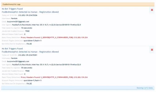

Just been reviewing the logs from this, and it doesn't appear to be catching human errors
An incorrect answer was provided
Today at 12:25 PM
CAPTCHA Name: VX220.jpg
generated_by_username_attempt: Marduk
generated_by_email_attempt: buzzwire2012@gmail.com
IP Address: 212.202.139.234
Expected Answer(s)
a:1:{i:0;s:5:"vx220";}
Users Answer
speedster
From the image itself:
CAPTCHA Statistics For VX220.jpg (3 humans, 144 bots)
Human Success: 100%
Human Passed: 3, Human Failed: 0
Bot Success: 0%
Bot Passed: 0, Bot Failed: 144
He registered OK on the next image
