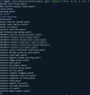

Just to give a bit more context so it's clear I'm not trying to be a wise-ass here in asking for an answer directly from the developers: we maintain a bunch of patches that have to be applied to XenForo each time we update. This is pretty cumbersome, though for small updates, it's mostly automated. It saves us a lot of time if patches get implemented upstream. Some of these will never be submitted as bug reports because they're too specific to our use case (e.g., the need for read replicas and special image proxy handling). Others have been submitted as bug reports or requests, but we know for certain they're not going to be addressed in XenForo 1.x. Here's what that set of patches looks like:
Those patches only contain changes that couldn't be handled by an add-on, typically because the classes involved don't use the dynamic instantiator. Every patch that we're able to eliminate from that list saves us time.
