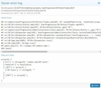

But I get an error:

But I get an error:
