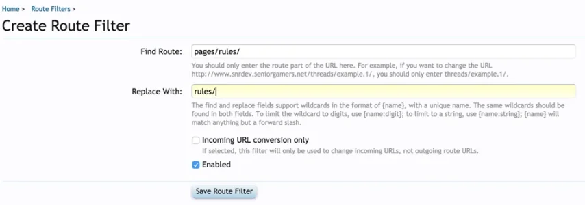

I found this example. This is what I did. I just dont know what to do next.
upload_2015-2-9_20-14-45-png.97878
ACP search for "Route Filters"
Create a route filter, then fill in the URLs as appropriate. Examples are given on that page, but assuming that you have currently named your Page as 'rules' and it is found at yoursite.com/pages/rules/ then you would do this:

But what is the purpose of the route filter in this case? I just want to create a single page -- and link to it in the navbar.
The route filter allows you to change the URL. So for example if you created your page, the URL would be yoursite.com/pages/rules/. If you didn't like the fact that /pages/ was in the URL, you could use the route filter to remove it (following my instructions) and the URL would then be yoursite.com/rules/.
