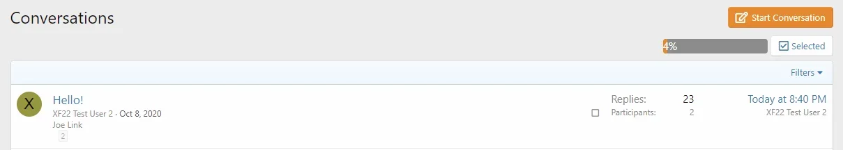

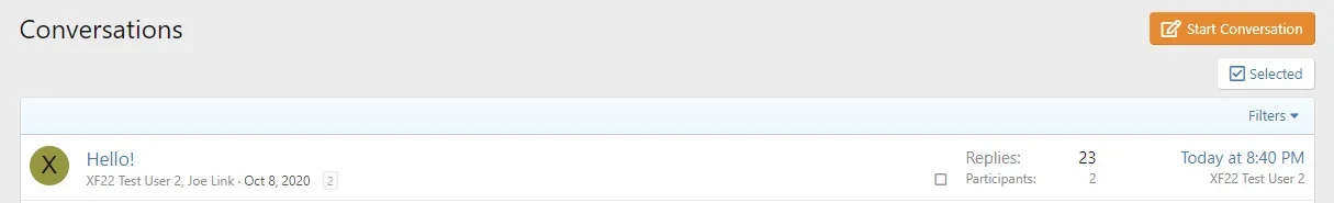

Seeing some sort of template/CSS styling issue on conversation_list with this enabled, using XF 2.2.1 with a default/unmodified style and all other addons disabled.
Disabled
Enabled
Wow, do you have any more info on it? I think I can fix it with CSS/template edits, if need be.
Need to overhaul the template modification, just working on fixing the 'mute single conversation' option which is honestly rather broken
