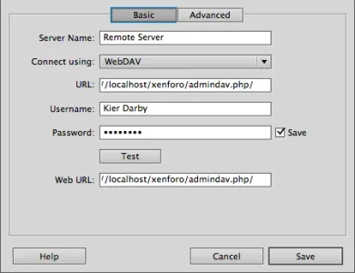

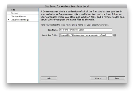

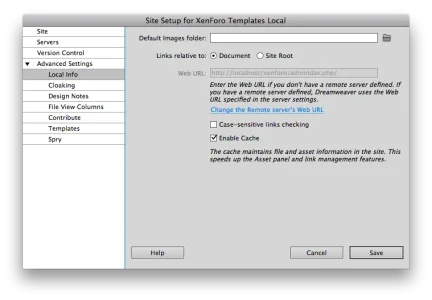

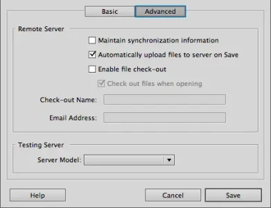

I'll show you my WebDav settings:
Screen shot 2011-02-17 at 03.54.46.png Screen shot 2011-02-17 at 03.54.57.png Screen shot 2011-02-17 at 03.55.00.png Screen shot 2011-02-17 at 03.56.01.png
