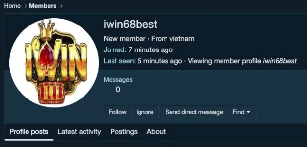

I notice the Vietnamese spammer is using IP's from other countries now and not just Vietnam. But, they always have "From Vietnam" in their profile page. Here is an example of one that is using an IP address from India. So, I cannot just block based on country.

I notice that the spammer keeps changing the Vietnam name to things like Viet Nam, Việt Nam etc. i.e. their location keeps changing.
