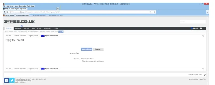

Basically, I've had a few members trying to access the site via SSL, and they get various errors with scripts being blocked by their browsers due to them being served via the HTTP CDN (such as the RTE not loading).
So, I've put this in config.php (which fixes the issue)

I'm not fussed about it warning that some content isn't secure (images etc), it was when loading the editor it was totally blocking it from loading.
I think you can click the little shield to allow it through, but none of the users new about that (I saw it in Chrome as well).

Changed my mind. This should fix the issue with people using SSL and it not loading the editor ;)
        # force HTTP
        RewriteCond %{HTTPS} =on
        RewriteRule !^(shop)$ http://%{HTTP_HOST}%{REQUEST_URI} [L,R=301]
