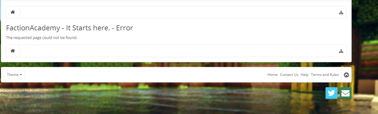

Basically got everything fixed. - However the only issue I have left is with confirmation Emails. I setup a Google A acc and made a email there.
It sends the email perfectly fine..
Sorry for big image lol. yea it wont let them register appearantly when they click the link in their email.. It just brings them here.
Any possible solutions at this?
