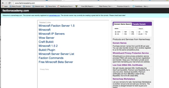

Main reason I say that is www.factionacademy.com gives you this
which indicates that your NS isn't set up to give the correct IP for the www.factionacademy.com but is for the non-www site. Whomever moved your site for you needs to update ALL the NS entries (specifically the one at CloudFlare that points - or actually doesn't point - the WWW aspect to the same IP as the non-WWW version). That is an easy mistake to make - but it makes me wonder about any others that were made in the move (especially if this was not a cPanel -> cPanel move).
With the mistakes I'm seeing just on that cursory look it leads me to believe their are more underlying mistakes that need to be corrected - which will need to be done by someone with shell access if on a VPS/dedicated server).

At cloudflare just create a cname entry in your DNS and point it at factionacademy.com

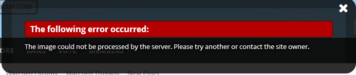

It isn't too big of a problem having the index.php in my urls. However I have gotten 2 main things that dosnt work for me at the moment. Not even sure if its related to the same issue.
But new players don't recieve their confirmation email and everyone get this
every time they try to change their avatar. These are really my only problems other then that Im not too bothered about the index.php thing :/
