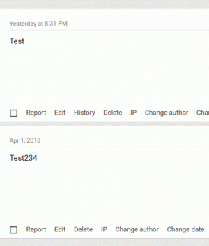

I have used the Change Date the first time now. And surprise, surprise! It changes the date, but not the position?!

It seems that the position was not recalculated for me.
Yes, is use 2.1; i try to download 2.2, but i cant find it? (only author, limit, resourcedate searching for "change")
As written before, the position is not calculated; so we have the 1. April 2018 after Yesterday.
