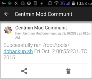

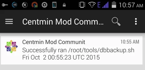

example pushover mobile device notifications
