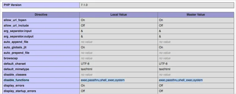

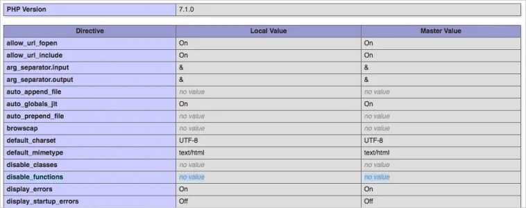

Hi Anthony,
Thank you for sharing your expertise. Can you please take a look at this issue:
WHM 60.0 (build 35)
PHP Version: ea-php71
When I enable PHP-FPM
When I disable PHP-FPM
Is there any way to enable PHP-FPM without disabling the following functions:
exec,passthru,shell_exec,system
Anthony Parsons
#28
Why do you want them enabled? My limited understanding is that these are the common exploits people attempt, especially known in Wordpress installs. Disabling those php functions is usually a good thing.
Do you need them?
