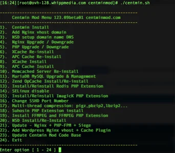

When I started modifying the original Centmin script for my own needs, I had a very specific configuration in mind for Nginx, PHP-FPM, and MariaDB. They would be custom tuned settings wise from out of the box installations - ready to hit the ground running with optimised specific settings. The source install method for common software also allows using more recent versions that what CentOS YUM repositories can provide and also lessen Centmin Mod user's reliance on the developer when new versions of software are released. The end user can just run centmin.sh menu options 4 and 5 to upgrade to newer Nginx and PHP versions without any delay in waiting for YUM repo based RPMs to be released or built. So with source compiles for Nginx and PHP, there is a shorter time between when the Nginx and PHP developers announce a new version release on their web site and the time you get to install that newer version on your server. For YUM repo installs, that more lengthy delay can be days or weeks even between Nginx and PHP developer announced new version and time you get to install the new version on your server.
And you have to bring in context at the time of this thread Floren developed and created his own custom CentOS YUM repo for more updated RPM packages via Axivo but that custom repo has been out of date and not maintained in years AFAIK. For Nginx and PHP-FPM at least, Centmin Mod's source installs removes the middle man - being the YUM/RPM package maintainers (and delays) and allows Centmin Mod users to just update or downgrade their Nginx and PHP-FPM versions when they see a new version offered directly by Nginx and PHP-FPM developers via centmin.sh menu system https://centminmod.com/menu.html without waiting on me to update Centmin Mod everytime. It ain't perfect as on a rare occasion, the menu routines could break and require me to update Centmin Mod code which I do ASAP as I have 120+ servers relying on Centmin Mod :) But Centmin Mod code is open source on Github https://github.com/centminmod/centminmod so anyone can fork it if they want to or contribute fixes and modify it to their needs if they want.
Also FAQ item 18 explains the advantages of source compile in providing features that no other LEMP or LAMP stack can provide via standard YUM repository installs
Nginx and PHP source installs also allow Centmin Mod to provide features and enhancements that not many other LEMP/LAMP stacks provide including. These are some features available optionally in latest Centmin mod 123.09beta01 and newer releases:

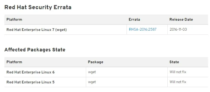

It's just not that CentOS/RHEL YUM updates lag before. There's some updates that fall through the cracks. Like wget CVE-2016-4971 security vulnerability. Basically, RHEL will not fix it for RHEL/CentOS 5 and 6 and only fixed it for RHEL/CentOS 7 and that was already a much delayed fix https://access.redhat.com/security/cve/cve-2016-4971. While, Centmin Mod LEMP stack already had a workaround fix for wget for CentOS 6 and 7 already. All Centmin Mod forum members and Centmin Mod social media account followers get alerts and notifications for Centmin Mod related critical and security fixes.
CVE-2016-4971
Impact: Moderate
Public Date: 2016-06-09
CWE: CWE-73
Bugzilla: 1343666: CVE-2016-4971 wget: Lack of filename checking allows arbitrary file upload via FTP redirect
It was found that wget used a file name provided by the server for the downloaded file when following a HTTP redirect to a FTP server resource. This could cause wget to create a file with a different name than expected, possibly allowing the server to execute arbitrary code on the client.
Find out more about CVE-2016-4971 from the MITRE CVE dictionary dictionary and NIST NVD.
Centmin Mod wget version for CentOS 6 and 7 fixed since July 2016
wget -V
GNU Wget 1.19.1 built on linux-gnu
There's other examples where CentOS 7 gets YUM updates before CentOS 6 due to upstream RHEL decisions. Which has shaped my view that if you're using CentOS, use CentOS 7 at least.
