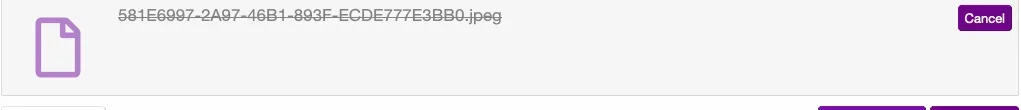

Don't know if this has happened to anyone else but i'm having a problem with uploading attachements to my site. It seems to be uploading but then crossing it out rather than showing the pic or video that i'm wanting to upload.
