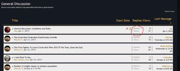

I've edited the text on my discussion/thread list page successfully so far by adding code to the EXTRA template..
However, I can't seem to alter the text colour of the 'replies' and 'views' text as displayed in the pic below. It's a light grey, and it's way too light on the background. I want black text. I have also had a fiddle in the discussion_list.css template and I've had no luck either.
This is a link to the forum itself: http://community.mmafederation.com/index.php?forums/general-discussion.4/
Does anybody have any advice/a piece of code that I could insert into EXTRA.css or any other template, to alter the colour of this text directly?
Any help would be awesome.
Thanks!!
Style Properties > Color Palette > @mutedTextColor
Thanks, but I don't want to change the mutedTextColor via color palette because that will effect everywhere else on the forum where that is used.
I want to JUST change the colour of the red circled area on the discussions list, as detailed above.
Try this:
.pairsJustified dt {
    color: #FF0000 !important;
Change the color to suit.

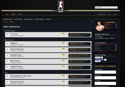

Hi :) I just tried that, and it DID change the text colour that I wanted to change, but at the expense of the red circled area on the index page of the picture below:
which is bad =/ because I want it as black text on the thread discussion list
but if the above text that is circled is black, it will obviously be invisible on the black background :(
I'm stuck =/
I posted the correct CSS above.

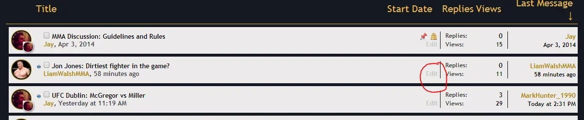

Hi, sorry to bother you again, but any chance you have a quick fix for the 'edit' text near the replies/views too? I would like that a darker colour as well.
if its a big thing then no worries, I just realised I forgot to mention it in this thread (see red circle on image below):

That's controlled via the : @faintTextcolor style property, I'm telling you this because if you feel it's to light there, typically it'll be across the board a lot, so it could be beneficial to darken it. I know with styles with a dark sidebar/light content it's a pain to get it correct in a smooth manner :).
For the link you want:
.discussionListItem .secondRow .controls a {
color: #000000;
color: #000000;
