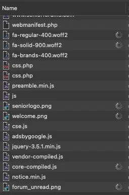

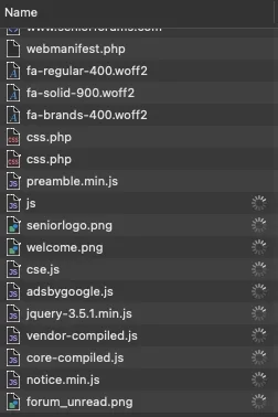

For what it's worth I have the same issue on my iPad, but it seems it's Safari more than the iPad, the same thing happens on macOS. Inspecting the requests, lots seem to be hanging, but I can access them directly:
Something network related maybe. Don't know if that helps, hope you can get it resolved.
