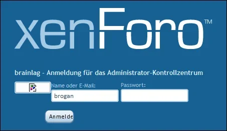

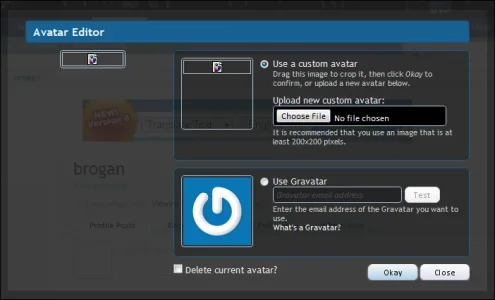

Hmmm, there seems to be an issue with images in general.
This is what I get after uploading an avatar:
And this is what I see when logging in to the ACP:
I've seen this problem before, I need to see if I can find the thread to see what the issue was.
