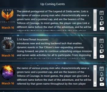

I am wondering couple questions on the Calendar ,first how far can the widget be modified I was looking for multiple links and the event Icon not user icon almost like the image below, and if it will work with Discord Integration to throw any added events post to the specific channel.
