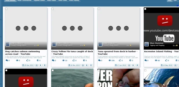

MG 1.1 blank thumbnails for videos
Blue chummer
Hi , was wondering if anyone else has the problem.
Some videos have blank or error type thumbnails and some have images. All of the videos work correctly when played
How can I resolve this error? thank you
see below:

This explains it.
There was a bug fix in a newer XFMG version. YouTube thumbnails will likely not work at all until you upgrade. The bug was caused by a change in the YouTube API.

I paid the extension fee and upgraded to 1.09 . Then I rebuilt the thumbnails and they worked!
