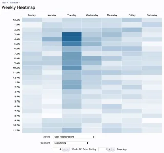

Usually that would mean you haven't been tracking it (all data points being the same at zero).Hmmm.... User registrations..... Every block blue, same colour.... What gives?¿?

I wouldn't think so, but no idea... I don't run it myself. Can't imagine why it would be interfering with something that has nothing to do with it. If it totally takes over the registration process, then yes... that could be an issue because the Better Analytics add-on, hooks into XF's registration process for the registration event logging.Hmmmm... Yes I am tracking it. This mod (crucial for my site) is maybe preventing tracking?https://xenforo.com/community/resources/external-authentication-privacy-by-waindigo.2858/
