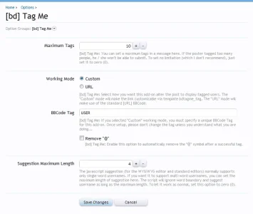

I duplicate this.Love the addon, but even after unchecking the "Remove "@"" option, the "@" is still being removed. ;_;
I duplicate this.

Just registered and posted. The "@" is not removed. Can you confirm this?Sure! It's http://stratics.com/community. It's not a huge deal. Just an interesting conundrum.
Yes, I see that it wasn't removed for you. I have no idea what happened between yesterday and today. This must be one of those situations when you call tech support, and their very presence makes the system start working again.Just registered and posted. The "@" is not removed. Can you confirm this?
