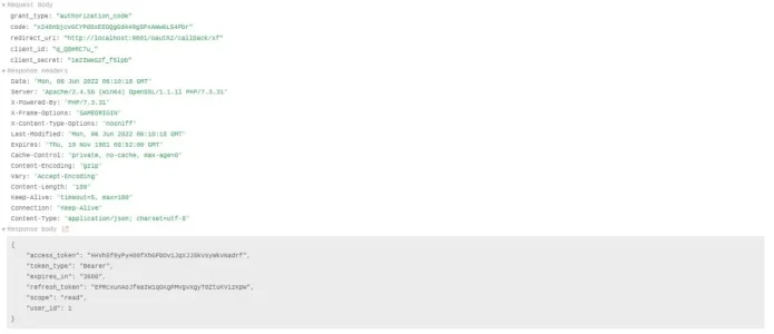

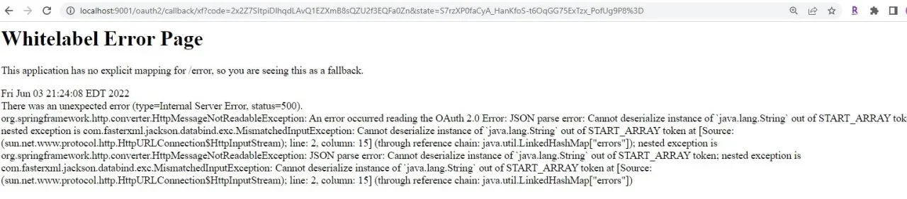

More question, when testing the bdAPI using authorization code programmatically, I was unable to keep going further once the authorization code got back to retrieve the token (for some reason it was working fine years ago), however when verify with another provider like discord, I was able to proceed next as I received correctly the token dialog. See screenshot using discord oauth2.
Any idea what could prevent this? Any changes from old version to latest beta version of bdAPI (Xfrocks-Api-2.2.0_Beta_1)?
The error I got back seems like the way data structure is not compliant as does data comes back from discord?
See screen shots (Xf-bdapi-1 and Xf-bdapi-2) after I hit Authorize :

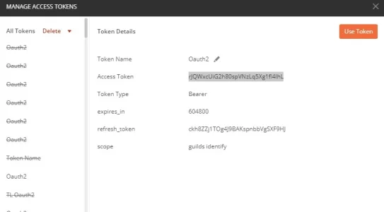

An error occurred reading the OAuth 2.0 Error: JSON parse error: Cannot deserialize instance of java.lang.String out of START_ARRAY token;
I was expecting a token like with Discord (dc response token.jpg) but instead error was thrown in parsing.
I suspect the token data structure may have changed since last I test an old version and my app failed to deserialize the object.
If the API is still maintained, any input is appreciated!
Thanks!
Updated: Finally got it working with latest version of XF 2.2.9 with both Php version 7 and 8, it turned out tokenUri was wrongly configured. In my case, I had to use whatever name, you gave to the folder like awesome-api instead of api as instructed if you want also to use XF rest API key. Man, it was not an easy one.
