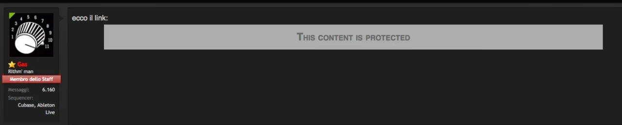

Hello, I think that there is a bug.
Now, in every private message, all the links appear as "protected"
Do you know a way to fix it?
Thanks! =)

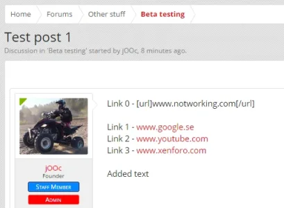

Hi,
I just maybe found a bug.
1. Created a post with links (With Bb Codes & Buttons Manager Off)

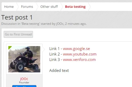

2. Enabled Bb Codes & Buttons Manager and edited the post, just to verify everything works with Bb Codes & Buttons Manager enabled

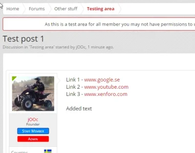

3. Moved the thread (With Bb Codes & Buttons Manager Off), everything looks fine

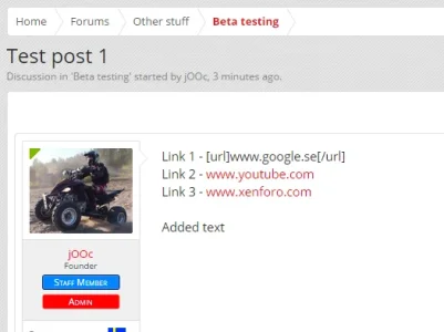

4. After the move I enable Bb Codes & Buttons Manager again
5. Now the first URL always fails to work.
Even if I add a new different URL its always the first one that is broken.
6. If I disable the Bb Codes & Buttons Manager the url's show up as normal again.
Can anyone verify this, or is it only for me it happens?
@jOOc
I've tested, I don't have the issue. I can have a look to your board (contact me by pm with an admin access and a ftp access to the bbm libraries) but probably not this weekend. If you find time, I would be nice of you if you can disable other addons to check if there's not a conflict.
