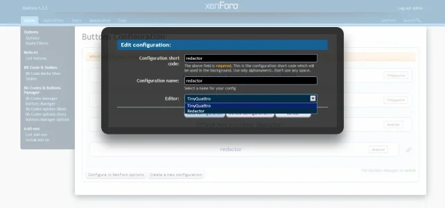

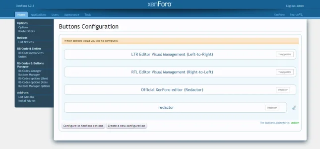

for additional check - i was fresh clean installation of XenForo 1.2.3 and BBM 2.3.3, but 01.webp02.webp
oh.. in helper "editors" value $mceSupport firstly set to true, and below is checked and set to true if TinyMCE installed. And in any case value is true :)
I think what previously it should be set to false.

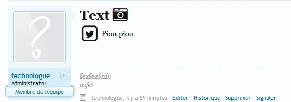

That's just something quickly done but it seems functional. All classes of Font Awesome should be working except the list (it doesn't suite a forum message anyway), to have the direct names which must be used inside the Bb Code option, check this file (line 183). The hardest to do will be the user interface and I don't know if I will have time to do it.
P.S: as usual the bbcode xml file is inside the extra directory.
Source:
[fa=fa-camera-retro|left|fa-2x][SIZE=7][B]Text[/B] [/SIZE][/fa]
[fa=fa-lg|fa-square-o|fa-stack-2x|fa-stack|fa-twitter|fa-stack-1x] Piou piou[/fa]
Note that for the stack mode (two icons combined together), all options before the option "fa-stack" will be for the first icon, then all options after it will be for the second icon. Only one exception: the global size option (ie:"fa-lg")will be applied to the wrapper).
