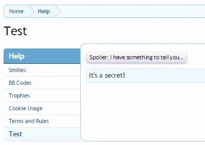

Personally, I'd go for just calling the bb_code_tag_spoiler template in the help page template, e.g.
<xen:include template="bb_code_tag_spoiler">
    <xen:set var="$titleHtml">
        I have something to tell you...
    </xen:set>
    <xen:set var="$content">
        It's a secret!
    </xen:set>
</xen:include>
