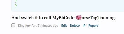

Speaking from the development point of view, this is a bad way to accomplish this. Place this in a file called "MyBbCode.php":
PHP:
class MyBbCode
public static function parseTagTraining(array $tag, array $rendererStates, &$parentClass)
$src = $tag['children'][0];
return 'blah';
And switch it to call MyBbCode::parseTagTraining.
That would be assTagTraining for any American readers ;)
a mod should censor the wordings above
Gee thanks XenStaff. :D
