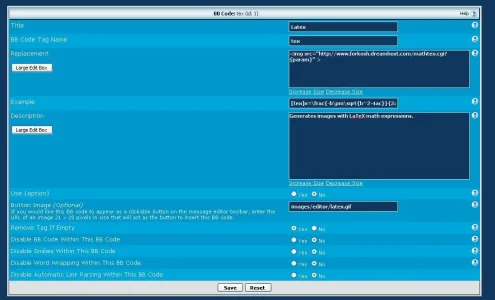

I installed this addon just fine and hope you can help us with the PHP callback. Here is the screenshot of the latex bb code in our VB setup

Looking at the screenshot, it appears that you just define a formula and the image source does all the work. Do a simple replacement with everything before {param} as the begin and everything after as the end and it should work for you.

I tried it before i asked the question, I posted everything in the replacement start and leave replace end as empty. I play a bit with it and remove the {param} completely
Now my replacement start is <img src="http://www.domain.com/cgi-bin/mathtex.cgi?
replacement end is ">
