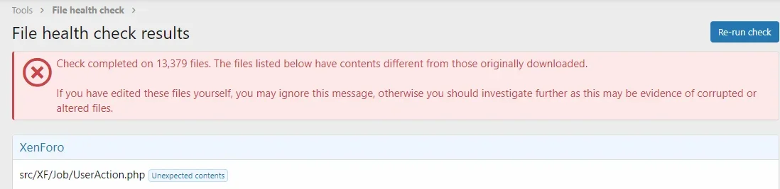

After making the above changes, everything seemed to work fine. However, I received a message. Can you guide me on how to deal with this situation?
This will flag files with unexpected contents which you can ignore for this file until the next release.
