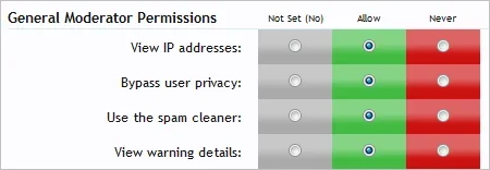

If a content moderator is created for a single forum, but they are then added to a usergroup which contains these permissions:
They'll be able to see all reports in all forums, right? And additionally presumably, actually perform those actions in all forums too?
Am I right in saying that a content moderator probably shouldn't be put into a usergroup that gives them moderator abilities, per se? And they should only be given permissions either at the node level or the user level, not at the usergroup levels?

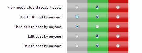

My moderating user group only has the base permissions which all moderators have.
The ability to edit, delete, etc. is set at node level.
Other than these, everything else is set to Not Set (No) for my default moderator user group:
For forum wide moderators, I have a Global Moderator user group which has a lot of other permissions set, as you would expect.
For content moderators, the permissions are set for each node, depending on their role.

Hey Brogan, have you experienced any problems with allowing moderators to spam clean?
We have reserved that for supers in vBulletin, but now it's a reversible action, I guess we could reconsider.

I can confirm the issue is that the usergroup permissions in the Staff - Moderator usergroup override the content moderator permissions.
When you create a Content Moderator for a specific forum, they are given the permissions you specify for that node only.
If you, however, put that Content Moderator into a group which gives them access to delete, edit etc. any post, manage threads etc. then that will occur globally and override any specific node permissions.
So, follow Brogan's lead and do not put them into a usergroup that gives them those additional permissions.
