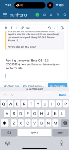

Running the newest Beta iOS 16.2 (20C5032e) here on an iPhone 14Pro and have an issue only on Xenforo’s site. Additionally tested on iPhone XR also running Beta and got the same result.
