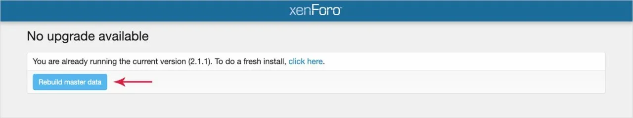

You need to restore all master templates and master language phrases to original. To do this you need to add "install" to your forum URL:
https://www.domain.com/install
After entering your username and password, you will see the Rebuild master data button:
Click the Rebuild master data button.
WARNING: Do not click the "click here" link.
