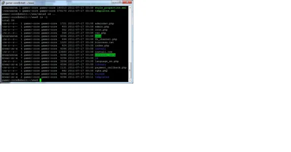

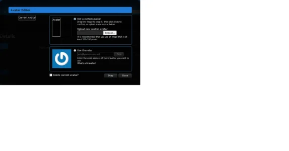

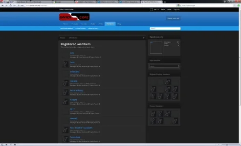

I bumped into a problem after the upgrade to 1.0.4, all users avatar is blank, but all the default avatars can be seen. You can upload a avatar but all you get is a black box.
Data and internal_data both have world writeable (CHMOD 0777). I have tried to removed the addons and skins (styles) but nothing have changed:(
The File Health Check are OK and it is no server error log.
Rest of the forum works perfectly.
Thanks for reading
