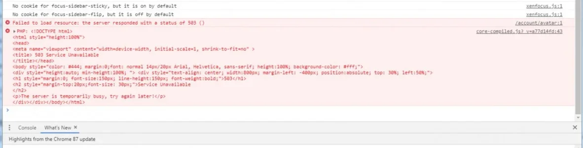

I'm having the same problem they had here, but no one posted their solution.
When I upload some gifs, I get the below error. Some gifs work, but it's very slow normally taking 20-25 seconds to complete the upload. This one is 3.5mb in size, we have a 5mb limit and it can't upload within the 30 second limit.
That same 3.5mb gif uploads to xenforo.com forums in 1-2 seconds, so I don't want to increase the 30 second limit.
Using imagick. Any suggestions on how to troubleshoot this or how to fix it?
Version: ImageMagick 6.9.10-68 Q16 x86_64 2020-04-01 https://imagemagick.org
centos-release-7-8.2003.0.el7.centos.x86_64
Features: Cipher DPC Modules OpenMP(3.1)
Delegates (built-in): bzlib cairo fontconfig freetype gslib jng jpeg lcms ltdl lzma openexr pangocairo png ps rsvg tiff wmf x xml zlib
