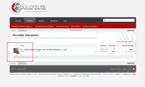

I have find a little problem (i think), when i click on "What's new ?", the blue button and moderation square are all, look screen:
So, the moderation is impossible, only to go a new post unread.
This happens for me as well. If I click the very top edge of the box, pretty much on the top border line, it selects as it should. Selecting anywhere else in the check box just jumps to the new post rather than selecting the thread.
Good find ... will fix it in next release ... I have few goodies coming up in 1.1.0.2
