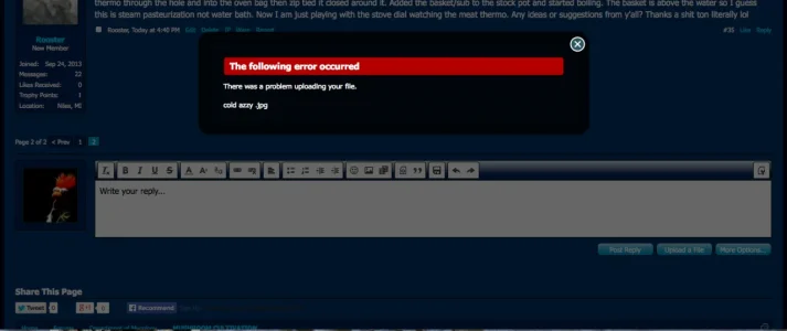

Alright, now I am really confused.
I went in and edited the attachment size permission in 'options' and upped the file size limit to 5500kb and thumbnail size, etc and it still gives the error.
It allows me to upload this 10kb file but not anything larger than 100kb even though the attachment permission is set to much higher.
This pic I grabbed off of a user uploaded fine
This one I took from a thread and it is only 364kb and it just gives an error.

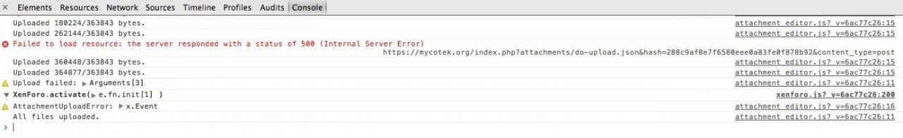

I don't believe it is an addon. I just tried disabling all of them and it still occurred. All I am running for addons are the Xengallery, BBcode in user status, and the XF Advanced search. It did this from the start when the software was first installed but I thought it was just a size limit permission causing it because it let me uplaod a small image but not a larger one. I was busy after the migration working all week so hadn't had time to finish with little odds and ends like those kinds of adjustments until this weekend.
I attached an upload of the error form the consol.... Looks like an internal server error.
500 errors are very difficult to debug as there is little to no information to go on.
