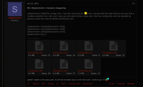

Certain posts with images that were attached previously do not display the image correctly:

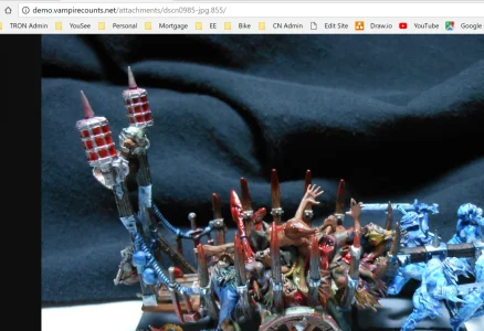

If I click on one of the image links (such as DSCN0985.JPG in the above picture), it loads and displays ok in a separate tab :

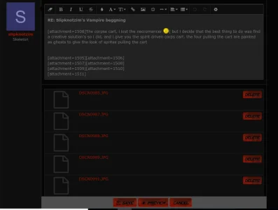

If I click to edit the post, it doesn't bring up the normal image options of inserting the image into the post, which makes me think that XF does not see them as image files:

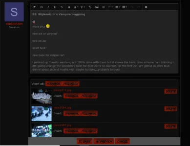

Images in other posts do display ok:

Was the forum ever on another forum software, before XF?
The reason I ask is that we have not ever had a BB code by the name of [attachment] we actually use [attach].
With that in mind, my current theory is that these inconsistencies have come in via an import from that software.
You could consider using the "Post content find & replace" add-on to replace those incorrect BB codes, though you'll need to check whether the ID within the BB code actually is correct, for example in case the attachments were imported with different IDs. If they were imported with different IDs, you'll probably actually be looking to just remove those BB codes entirely.
