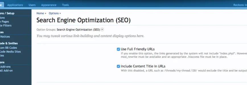

XF 1.5 appropriate .htaccess for Full Friendly URLs
There is nothing to do in htaccess file after that unless you're facing any issues with the friendly urls. Have you enabled "Use Full Friendly URLs" in ACP > Options > Search Engine Optimization (SEO)
