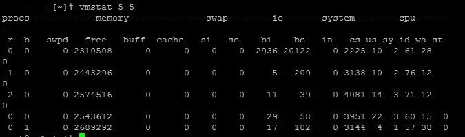

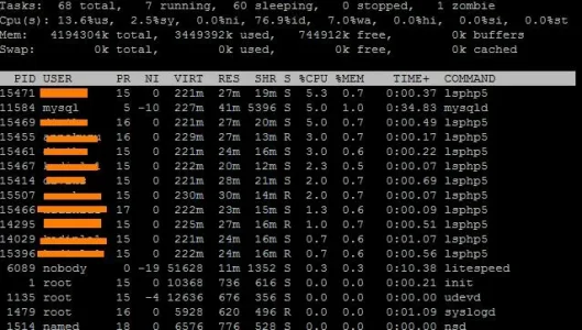

Do you see any processes taking up a lot of CPU time? Can you check MySQL to see if there are hanging queries?
