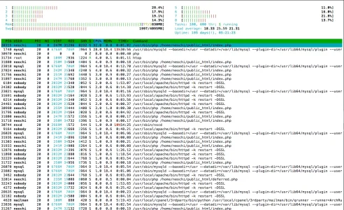

I've also uploaded a screenshot of htop during it going crazy.
